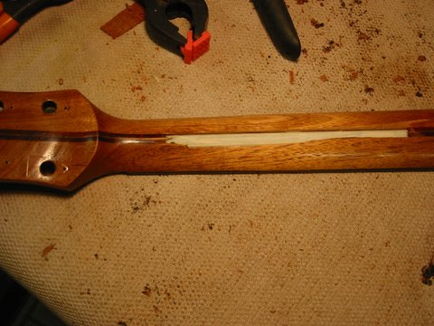

Well ran into a major problem today. Will post some ugly pictures. Was playing the heck out of this build when I noticed the neck felt funny right where my thumb was up around the 3rd and 4th frets. Litte more investigation and I noticed the laminated center was flexing and as it turned out I must have thinned the neck just a wee bit too much leaving the center at the peak weak - tore out some of the wood and it was probably around .06. Ahhhhhh darn!!!! Not what I really said but being polite.
Sooooooooooooo. I ended up yanking the neck off tonight and started on a replacement. I hate when that happens
Well good news is I am aparantly getting better at removing necks and fretboards from soundboard. This is not my first. Pulled off cleanly and had another neck on hand that I was planning to use for another project. Not going to redo the laminated style - just no patience.
I hate having to redo anything. My mind was all set on this project being done and now I have to spend another day replacing the neck when I was hoping to finish up a bunch of other half done builds. Oh Well - back to work in the morning.
Will post pictures of the ugly neck as warning for others like me who might not be paying attention and thinking there is more wood to work with than seems to be from intuition.
Every build brings new challenges to overcome and I guess that is the learninng opportunity

A picture of my thin neck. There is no repairing this one. I am replacing. Will hang this on in the workshop as a reminder.
PostPosted: Wed Aug 09, 2006 10:22 pm
Well Rich, if you're not a patient man like you say you aren't, let me say that you have the right attitude now, you'll be playing in no time with your new neck installed...

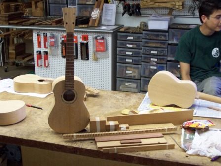

Sorry I couldn’t post these photos sooner but my computer was ill. Here is a photo of a basic Hana Lima ‘Ia tenor ukulele kit that is made of Honduran Mahogany and rosewood.
That is my unfinished first uke next to it.
This is a photo my wife took in our hotel room. The ukulele was not finish sanded as much as I would have liked. It was roughly finished up to 220 grit and then got a scrape job. The finish is one thin coat of tru-oil and then right into stringing and setup. My only opportunity to take the class was in a condensed form. I learned a lot but due to time constraints I was unable to be a thorough as I would have liked. But I have a much better idea of what I am looking for now and can move forward. Sorry to be boring. Anyway this is a photo to show the quilted mahogany that Hana Lima ‘Ia can provide in a custom kit.
Best of Luck
Philip
aka konacat
